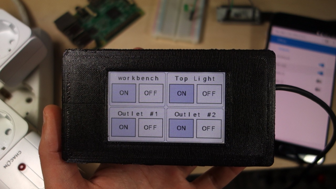

yes, you can do that. You would have to design the Nextion HMI to have a text field on screen, then via serial from the ESP8266 (D1 mini, etc.) you would send the proper command to the Nextion display with the text as the payload to be displayed.
Check out the Home Assistant Switch Plate (HASP) Project. While it doesn't use ESPHome, the concepts are the same.
HA SwitchPlate HASPone
[Three Screens]
A DIY touchscreen scene controller that fits in a standard switch box
[Scene control]
[Status Display]
I had been looking for a clean way to control Home Assistant that would fit into a standard single-gang work box / switch panel. Lacking good options on the market I decided to design and build one myself.
The HASwitchPlate 1.0 (“HASPone”) can display a series of pages, each with a custom set of buttons. There are several default button layouts …
