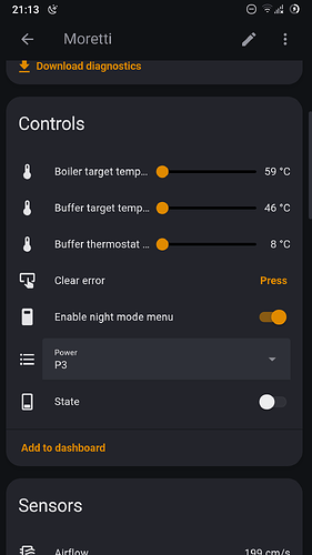

When talking about sliders it is Android issue. Works in PC but not in Android. Specifically with older android versions.
I do not have emulator and will not set it up for just that so I dont know from what version exactly this behavior (generic slider does not show in correct position) appears but I can say that in Android 11 and below, it does not appear correctly.

I use 2 devices specifically for HA, in Android11 this is what I see in companion app
In browser everything looks fine. In My HA tablet with android 6 everything is as in image both - app and browser. But overall companion app in older versions of android is worse last 6 months or so. In that old tablet the app is getting so unbearably slow now that I use only browser for HA.
