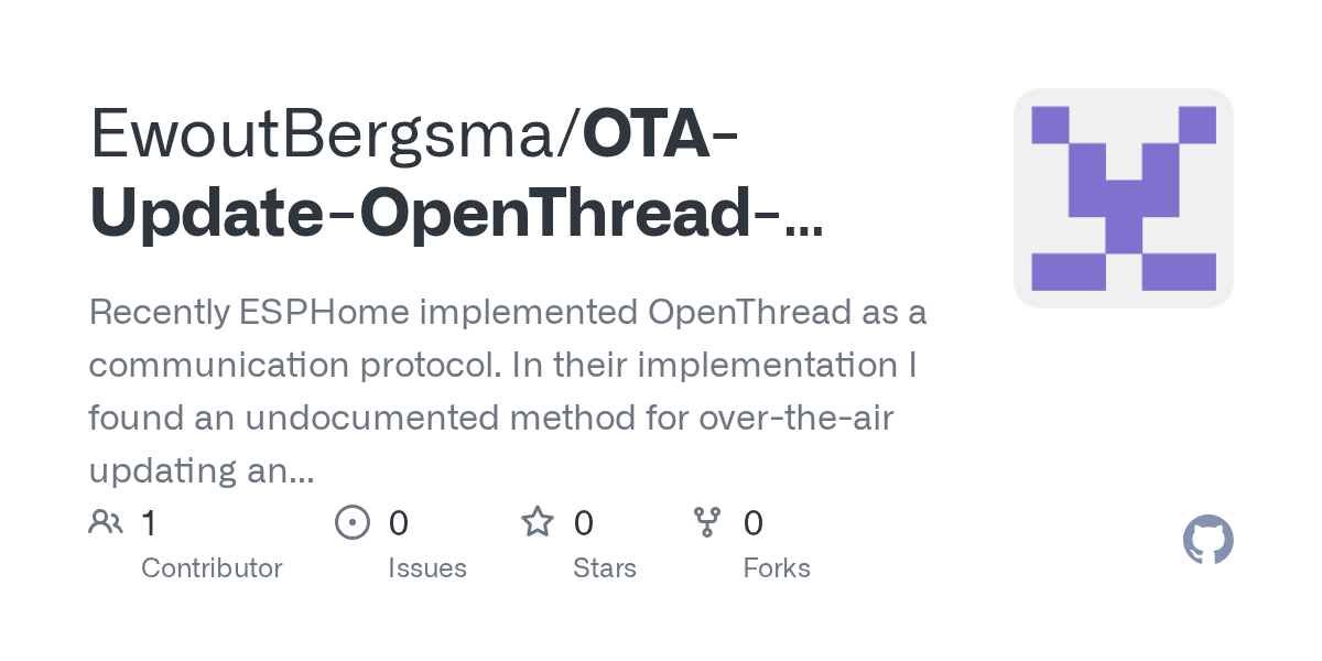

For those that find this thread and got confused (like me), the above posts are outdated. It currently is possible, I made a small write up on this:
