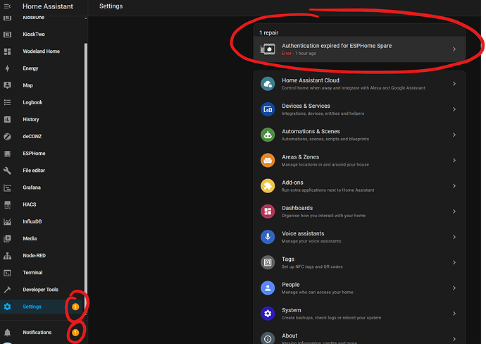

At some point in the past I called an ESP8266 device “ESPHome Spare” (friendly name) I have since updated the friendly name of the device (im not even sure which device I called “Spare” now as I have 10 device in total). Recently out of the blue im getting it being “detected” or proposed as a “repair” and I cant clear/resolve it from popping up!. I have tried a quite a few things
This is what I see
Authentication expired for ESPHome Spare
If I click it
The ESPHome device ESPHome Spare enabled transport encryption or changed the encryption key. Please enter the updated key. You can find it in the ESPHome Dashboard or in your device configuration.

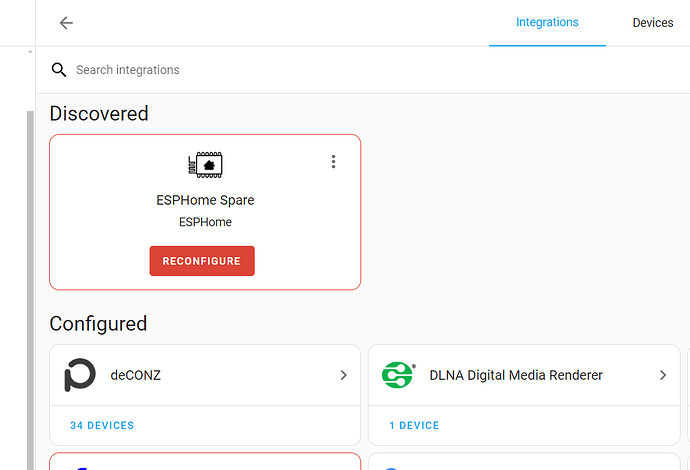

In the “Integration” section I see
And if I click it I get asked again for the encryption

Random fluke!!! I have just fixed it
I just randomly went into settings / Intergrations / ESPHome
and had this option
Which I clicked on Reconfigure and boom fixed!!! - Random!
