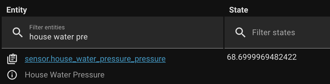

One thing I’ve noticed with using round is I see the ESPHome logs show the rounded value:
[09:12:13.767][D][pressure_tag:036]: Raw value before filter: 0.524414 (68.2)
[09:12:18.767][D][pressure_tag:036]: Raw value before filter: 0.525391 (68.3)
[09:12:23.774][D][pressure_tag:036]: Raw value before filter: 0.528320 (68.7)
[09:12:23.781][D][sensor:135]: 'Pressure': Sending state 68.70000 psi with 1 decimals of accuracy
[09:12:28.775][D][pressure_tag:036]: Raw value before filter: 0.527344 (68.6)
[09:12:33.776][D][pressure_tag:036]: Raw value before filter: 0.525391 (68.3)

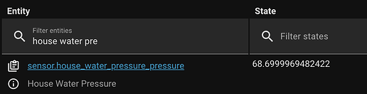

But the state is showing a large number of digits.
I assume that is some round-trip precision error happening on the HA side where API receives the text 68.70000, converts to float and back to a string again.
$ python3 -c 'print("Round-trip:{:.20f}".format(float("68.70000")))'
Round-trip:68.70000000000000284217
Before the delta above I was saving a lot of state data, so that update frequency is better now. I was using round to make HA see fewer state change. But if the conversion error is the same every time maybe it makes no difference.

Right. It must be a round-trip “error” and it’s pretty harmless since the conversion of the rounded number results in the same value every time (so no state change). I assume HA has no knowledge of round used in ESPHome config, so it can’t really know to round the value before saving as text.
One can see how it’s a little confusing when round is used in ESPHome but it doesn’t look as expected in the resulting state.

By the way, I think it’s kind of interesting how the conversion is working:
sqlite> select state, anything_updated from states_by_name where entity_name = 'sensor.house_water_pressure_pressure' order by state_id desc limit 15;
state             anything_updated
64.1999969482422  2025-12-28 07:33:29.182
59.2000007629395  2025-12-28 07:32:49.178
54.0              2025-12-28 07:31:58.155
59.0              2025-12-28 07:29:37.115
64.5              2025-12-28 07:28:52.211
unavailable       2025-12-28 07:28:37.740
64.0999984741211  2025-12-28 07:28:01.627
62.7999992370605  2025-12-28 07:27:51.625
61.5999984741211  2025-12-28 07:27:46.622
59.7000007629395  2025-12-28 07:27:41.621
61.7999992370605  2025-12-28 07:27:36.620
63.0999984741211  2025-12-28 07:27:26.619
61.5999984741211  2025-12-28 07:27:16.608
58.4000015258789  2025-12-28 07:27:11.603
52.2999992370605  2025-12-28 07:26:56.602
It kind of looks like HA is just trimming trailing zeros, which is the interesting part.
(This doesn’t look exactly like how the conversion is happening, but shows the round-trip results.)
homeassistant:/config# python3 -c 'print("Round-trip:{:.30f}".format(float("64.5")))'
Round-trip:64.500000000000000000000000000000
homeassistant:/config# python3 -c 'print("Round-trip:{:.30f}".format(float("59.2")))'
Round-trip:59.200000000000002842170943040401
Again, not a problem, just interesting. No point in saving those insignificant digits.
