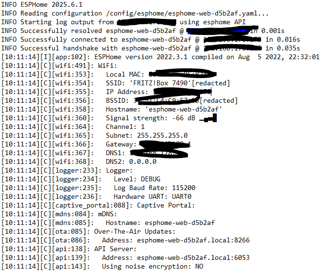

I don’t know if it gives any good ideas but here is the log download from the Device. note this was actually compiled in 2022 with the same YAML. I have around 8 devices currently performing correctly but none of them will compile same error as in my original message
