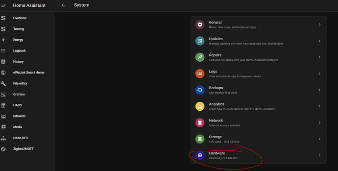

Thanks do you mean Am I running 32bit version of OS of the pie4? or Homeassistant? Sry I am a bit lost :wink:
how and where do I do the command line? within HA or I need to access the Rpie itself and type it there?
I guess this makes it clear that I am running 32bit right?
So i just update the Rpie OS to 64-bit and reinstall HA on it and it should work?
Yes, I didn’t realize that it was displayed there. The pi4 can run the 64bit version. Unfortunately you will need to reinstall home assistant. You will need a backup recent backup stored off the pi to restore.
Yes. But don’t forget to make a full backup beforhand and make sure restoring from that backup works! You will most probably loose all your data when updating the OS!
