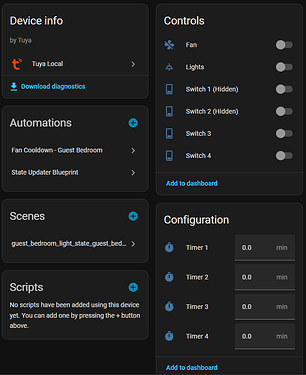

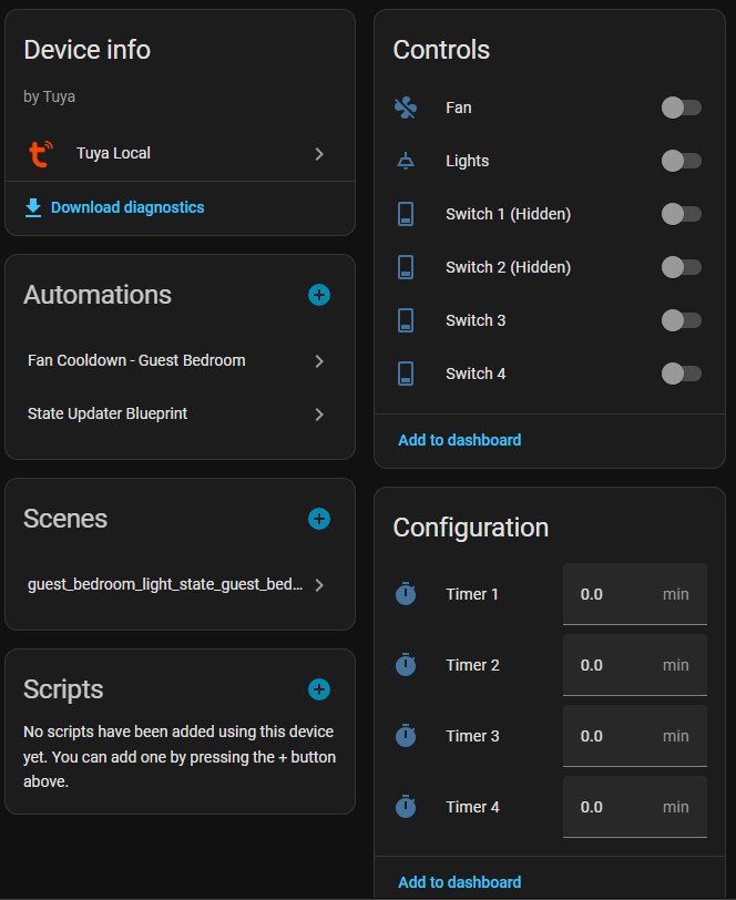

Hi everyone, I’ve added the DP mappings of various Aziot/Homemate products to “Tuya Local” integration available via HACS. So using the latest release, all Aziot switch will work with local control when configured with local key taken from Tuya IoT cloud.
PR - Added support for Aziot 8 & 7 Node smart switches by pranjal-joshi · Pull Request #3606 · make-all/tuya-local · GitHub
