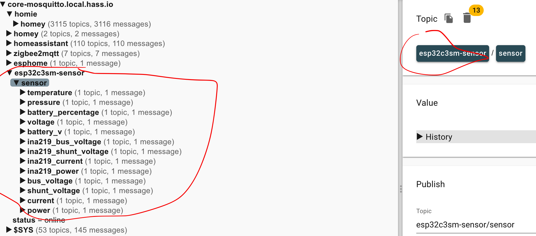

I would like to ask you guys for some explanation as I am getting slightly lost with the ESP & mqtt and please do excuse my basic question - if I get an ESP device into HA is it automatically discovered by mqtt and broadcasted? Example - I have an ESP32 with BMP and INA sensors with few entities. No mqtt configured in ESP yaml code. The device is visible in the Explorer and I have access to the sensors’ entities also in my Homey that gets mqtt communication. I can not however see these sensors entities under mqtt integration…
Your kind clarification for a noob would be highly appreciated…
TIA.
Then it won’t be using MQTT, nor will the sensors appear on your MQTT broker.
The only way (mostly) for an ESPHome device to connect to a broker is if you define the MQTT broker in the YAML, and turn off the api for good measure.
I was thinking same way, but :slight_smile: - it appears in the MQTT Explorer (?) and as I wrote - I can get it from HA to my Homey, which do communicate with each other using matt… I have intentionally deleted the mqtt config in yaml as I had duplicated sensors when I have added device to HA, now I only have single entities but still mqtt explorer sees it… I can not understand that…

If retain was set to true then the broker will cache that forever. Delete the topic in Explorer and see if it comes back. Click on the top level of the topic - then top right of Explorer in the Topic pane there is a little bin symbol to remove it.
I guess there was no retain setting but I think it defaults to true. After deleting this topic from explorer it is not coming back. Thank you for helping me understand. Best. JU.
