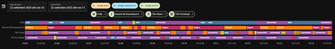

Polly, my cat, is in the purple room (cameretta - kids bedroom)
Xiaomi Smartband is in the red room (bagno - bathroom)
The two tiles are both in the purple room
Those are the presense reported with original settings on all ESP32 (Absorbtion 3,5 and max distance 16):
And this is after I play with absorption and max distance
Seems like whatever I do this is not improving a lot.
I also noticed that depending on the device, the consistency of how it is reported. For example the 2 tiles are sometimes reported to be even in my underground floor and in the garage!

This is the situation now, the 2 smartwatch are rock solid shown in the right room:
The cat is in the garden at an equal distance from the garden transmitter and the blue room, I noticed that when I open the window of the blue room he is reported sometimes in the room and sometimes in the garden.
