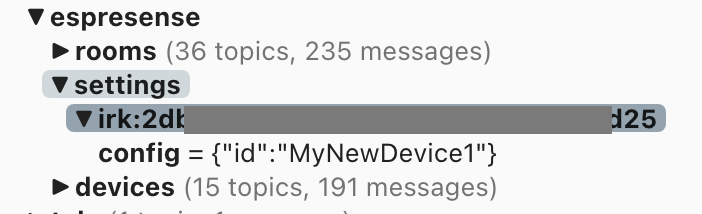

Next, to get the IRK value (not shown in the fingerprint screen), you will need to take a look at the MQTT data your Espresense is publishing. To do this, I use an app called MQTTExplorer to view all the MQTT data being published to the MQTT broker (super handy tool if you haven’t already discovered it). Under the node espresense > settings you will find an irk:your_irk_value_here entry. To confirm its the right device, if you expand it, you will find a config entry with the device name you used during the first Enroll step.

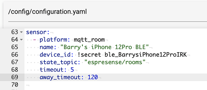

Now that you have the irk, you need to add it to your HA configuration.yaml as a sensor:
The device_id is where you put the IRK value, you need to enter it as follows (note that I have mine extracted to the secrets file which is a good practice):
device_id: "irk:abc123etc"

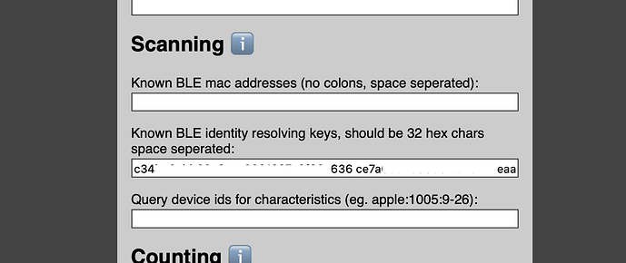

You should also then visit the default config page on your Espresense device to populate the configuration with the known IRK number. Note the format here is without any irk: prefix, just the value and for multiple irk values, space separate them. Ideally, register all your devices in one session on a single Espresense device and add all the IRK values to one, and then copy and paste the entire string into all your other Espresense device configs.
