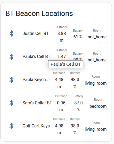

Just sharing this if anyone interested. The HA display/card is still a work in progress and needs cleaned up but, that isn’t really what’s important here. I’m just showing that you can use the BT beacons for room presence that shows you the Room, Distance, and Battery Level of the BT beacon whether it’s a phone, watch, or what many of mine are is BlueCharmBeacons. They work very well with HA and just in general. They are also a very good quality product IMO and i have no affiliation.

If someone has any better suggestions for displaying this information in a HA card then don’t be shy!
