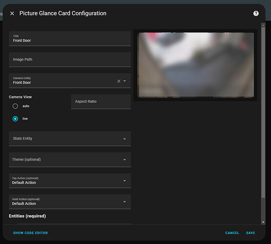

I’m not looking to stream though. Simply trying to make them work so I can view within HA occasionally. Not sure how exactly to do that. Everything has been brought in and appears to be working but can view a live stream even though I can see the preview. Have tried both picture entity and picture glance cards with calling service camera.turn_on as a service tap action etc etc (not shown in this screenshot). Are there any tutorials out there that you know of?

Do I need to go back to using RTSP stream just to make it work? What then becomes the use of the Eufy Security integration if I’m just taking the raw stream and bypassing the integration? Am I just to use the Eufy integration to get access to all the entities but not use it for the actual video feed? Sorry if I’m confused.
You can manage your devices with lots of entities, you can initiate rtsp stream on demand without a motion event and for many, you can stream your camera even without rtsp support
This is what I’m trying to figure out now. Am I able to get the stream of the camera without using rtsp and using the eufy integration directly?
