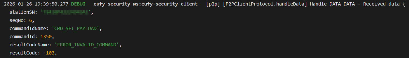

The problem is that a few months ago suddenly (some update? some change in the camera’s firmware, who knows?) the switch to enable or disable the camera is not working. The camera gets the request from the eufy security integration, but it refuses to pickup the request.
We have an Eufy doorbell as well, and when I use the same switch on the doorbell the camera goes off and on.
I enabled debug mode in the add-on and this is coming back from the camera:

Any clues in the error logs?
Nothing in the HA core logs. That’s why I enabled the eufy security debug mode. That’s the only info I can gather.
Eeh ok, just updated to version 2.0.0 (just released two hours ago) from 1.9.7 and problem solved. Wonder what did the trick?!
