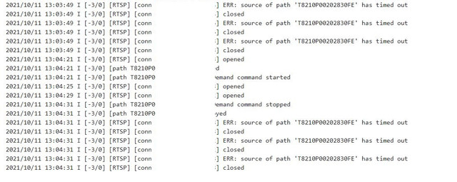

Iâm gettings strange results with my 2 cams.
Sometimes i have video (very fast)
Sometimes errors:

Looking at the rtsp addon, it shows timeouts for the doorbell
Even eufy security log has errors
It says its streaming already but the sensor streaming says false lol
In that case, there is nothing to do other than restarting add on. Integration heavily relies on add on actions and responses.
