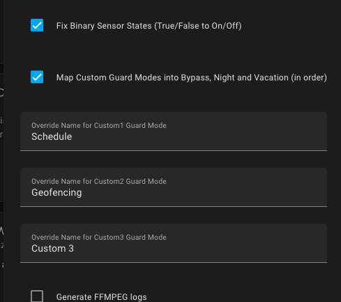

Do make sure you have mapped them in the integration
Screenshot 2022-08-16 at 18.18.17
(ignore I added ‘schedule’ once. It doesn’t work as far as I know off, as the idea is to write your own schedule in HA and not depend on the one in Eufy).

I don’t actually have any custom options set up, but even looking at the list I’m a bit confused
Eufy has the default modes of:
  • Home (alarm_arm_home)
  • Away (alarm_arm_away)
  • Off (?)
  • Disarmed (alarm_disarm)
  • Geofencing (?)
  • Schedule (?)
It seems like the night/vacation and bypass are reserved for the three custom modes that can be created, so how do I use Away / Off / Geofencing / Schedule?
From memory:
Home → maps to Eufy ‘home’ - shows as ‘armed home’ in HA
Away → maps to Eufy ‘Away’ - shows as ‘armed away’ in HA
Disarmed → maps to Eufy ‘Disarmed’ - shows as ‘disarmed’ in HA
Geofencing is a custom mapping to map to Geofencing, not sure it works. Also don’t use it.
Schedule last time I checked and as I understand doesn’t work. The idea is that you can write the schedule better yourself in HA.
The thing that took me a bit of time to realise is that in essence ‘Home’ and ‘away’ are armed modes, and disarmed is truly turning your alarm off. It also works like that in Eufy. But the app -at least for me- didn’t really present it as such. Displaying everything as ‘equal’.
