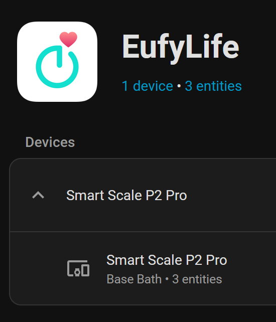

I had ended up purchasing a 3 pack ESP32 Wroom for $15. Loaded ESPHome as the Bluetooth proxy. Instant connection and it just works. The scale shows up as if it was connected directly to HA.
The entities I can track are weight, real-time weight, and heart rate.
