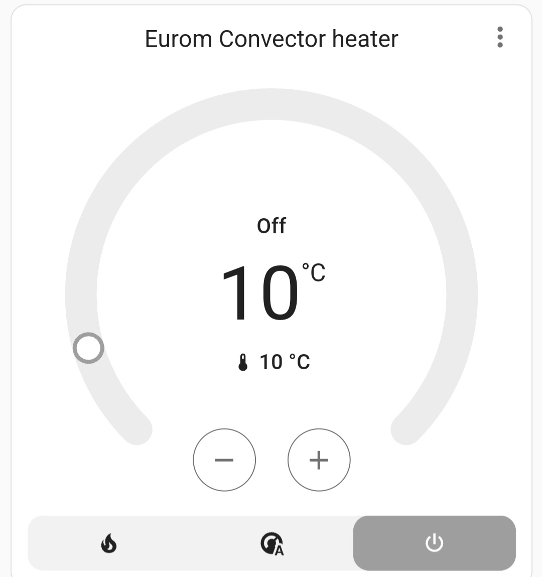

I made a automation around it, controlled by a aqara temperature sensor. But i found that it is not always showing me the correct states in the eurom card
It is correct switched on, i see the correct status at tuya app. But i do not see always the correct status in ha

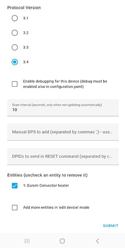

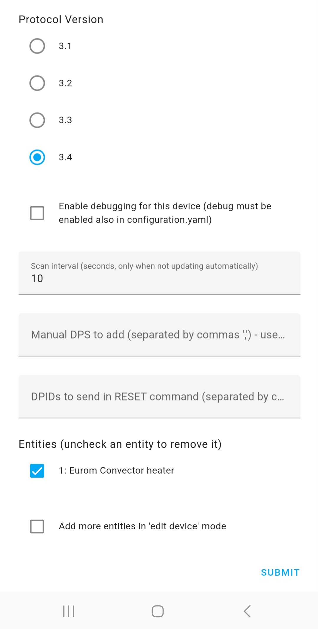

Im using protocol 3.4. Protocol 3.3 was not working for me
I also activate scan interval 10sec, hopefully this will fix my issue

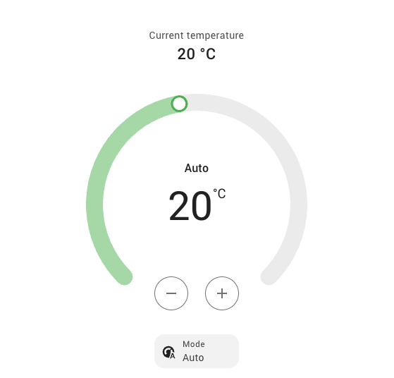

I’m hoping to get it set up like you do in your screenshot. Sharing your file might help me get this fixed.
I currently have it set up like this (see screenshot). But changing from Auto to Heat or Off does not work for me.
Thanks in advance!
