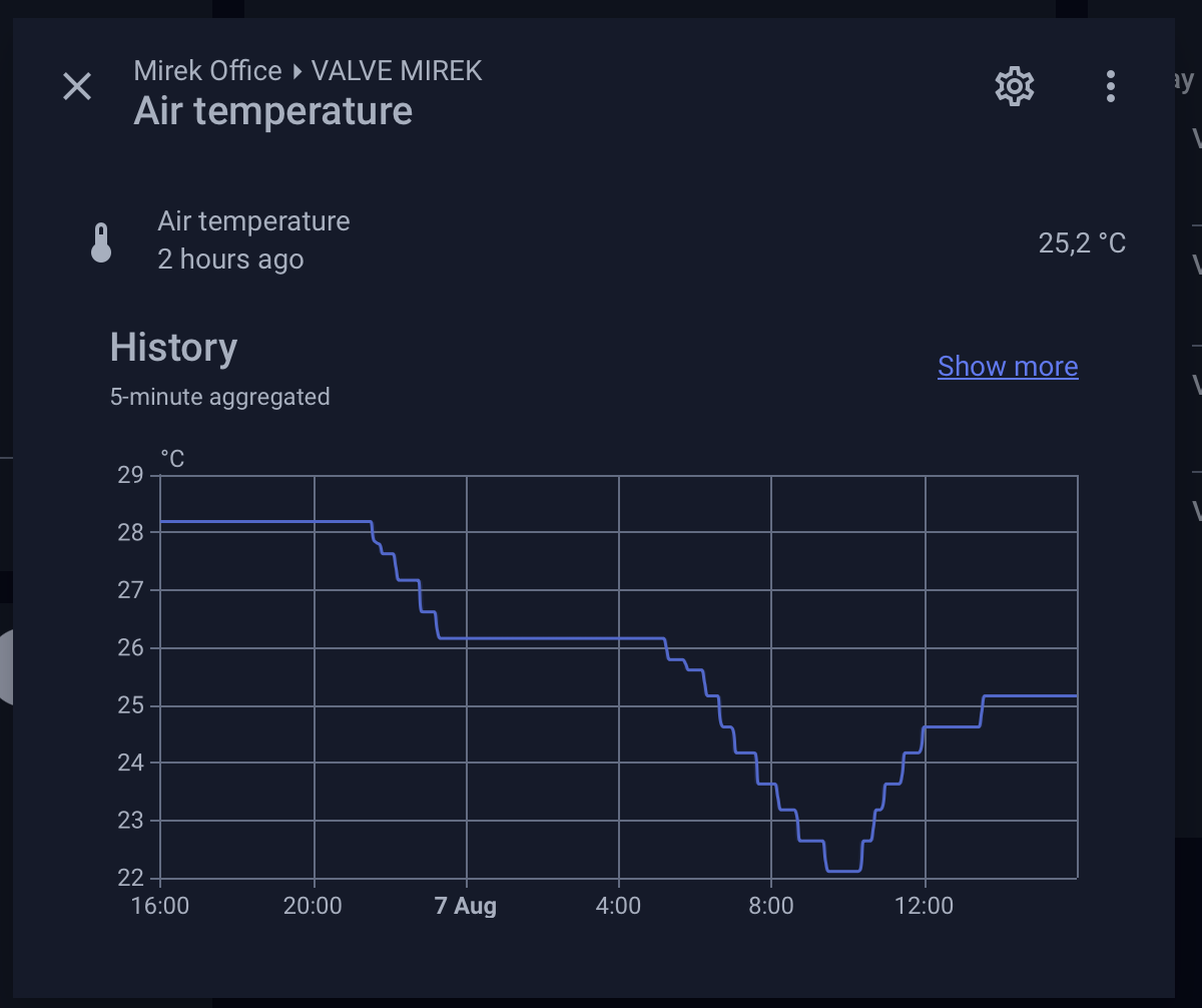

Hum, you’re luckier than I am then. Here’s what mine look like:
I’m well aware of the drawbacks of such temperature sensors (being way off) but this is not my issue here: the reporting frequency is.
