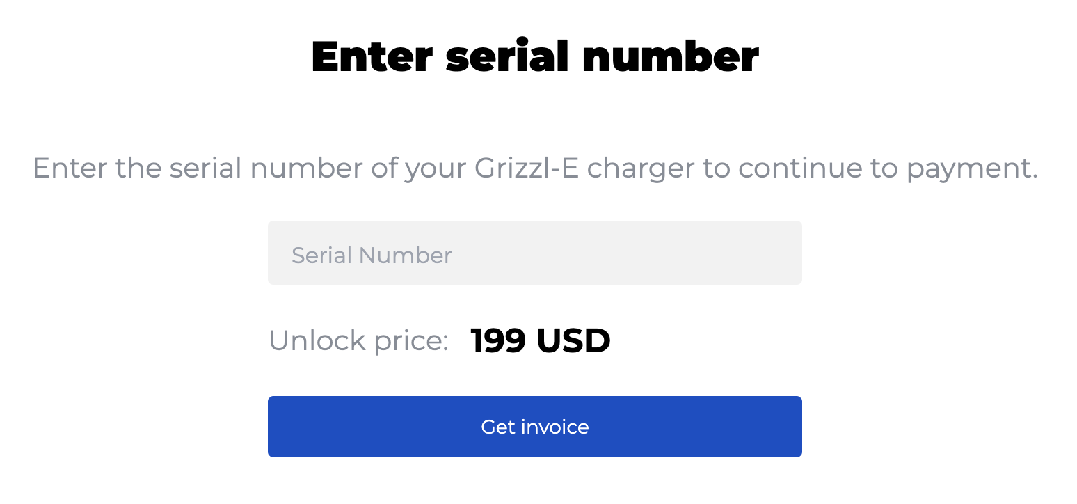

It lloks like we have to pay extra $199 per a unit to unlock OCPP for Grizzle.
I wish I had even that option. (not really but…)
