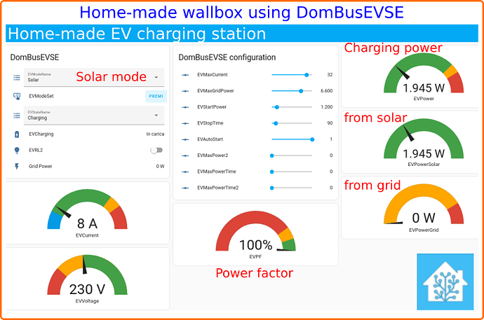

Nice smart way to charge the EV.
Did you also tried the home-made wallbox using DomBusEVSE module?
It works with HA and have several nice features for your component:
managed mode => perfect to work with your component because you can set any current between 6 and 32A, 1A step
Also, you can set a minimum voltage to keep, for example 250V, so it charges the vehicle using the minimum current to keep the selected voltage: this is very useful for those who have a photovoltaic system that starts power derating in case of excess power from the sun (V>=253V) and have the vehicle battery almost full.
