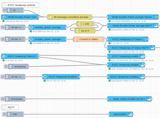

Ok it works more or less but with some timeouts.
Here my config. But keep in mind that eventually there are some improvements made in the meantime. For the power consumption I use a Shelly meter.
In HA I use Node Red for the MQTT commands.
