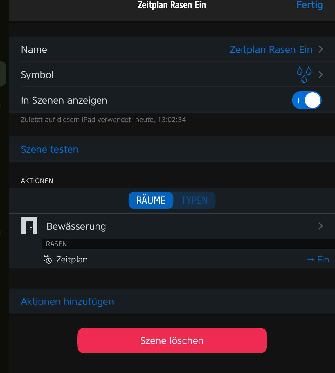

Hi, I will include a few screenshots, but unfortunately I have everything in German. Maybe it will provide you with enough guidance though.
First, in the EVE App, I have created a Timeplan (Zeitplan) for the valve:
Then I created 2 Scenes which activates or deactivates the (Zeitplan xxx Ein / Zeitplan xxx Aus).
One example:
Then, in Homekit I created an Automation which executes the Scene to activate the Timeplan when the toggle (defined in HA) is set to on (based on a Humidty Sensor in the soil) and an Automation which executes the Scene to deactivate the Timeplan when the toggle is turned of.
One example:
