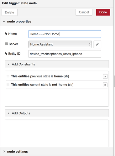

yes there is a HA trigger node in which you can set the “previous” and “current” state … it will only trigger when it changed according your setting. I can share a mini flow when I’m back home … but its very easy to find :wink:

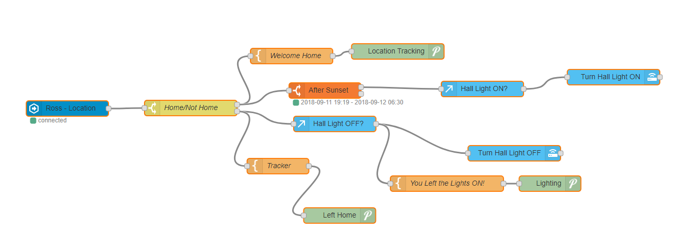

This is mine for presence detection.
The State node will only allow it to continue onto the next step if the payload goes from “home” to “not_home” or “not_home” to “home”

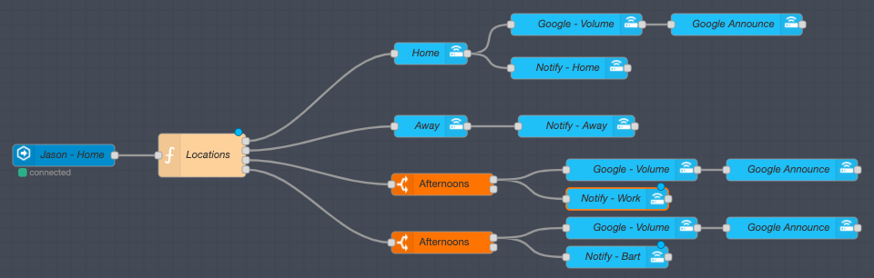

I have figured it out with some help from others… I have a function (Locations) that has the following in it:
var newState = msg.data.new_state.state;
var oldState = msg.data.old_state.state;
if (oldState == "not_home" && newState == "home") {
    return [ msg, null, null, null ];
else if (oldState == "home" && newState == "not_home") {
    return [ null, msg, null, null ];
else if (oldState == "work" && newState == "not_home") {
    return [ null, null, msg, null ];
else if (oldState == "BartStation" && newState == "not_home") {
    return [ null, null, null, msg ];
else { return [ null, null, null, null ];
Here is the screen shot of the node-red.
@MechEng70 what payload are you passing from “Jason Home” and how are you defining msg.data.new_state.state and msg.data.old_state.state. Thanks
Jason - Home is using person.jason that uses my phone to track my position. you could use the device_tracker.yourphone
