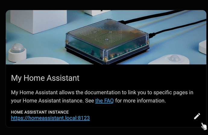

The redirect-page you see when clicking “Add Integration” still shows the old URL under Your instance URL: http://homeassistant.local:8123 so I think that must be the issue.
How do I fix this?
Due to my dark mode extension’s configuration I first couldn’t see there’s an edit-button on the my.home-assistant.io page:
I used it to enter the new URL and now everything works fine again.
