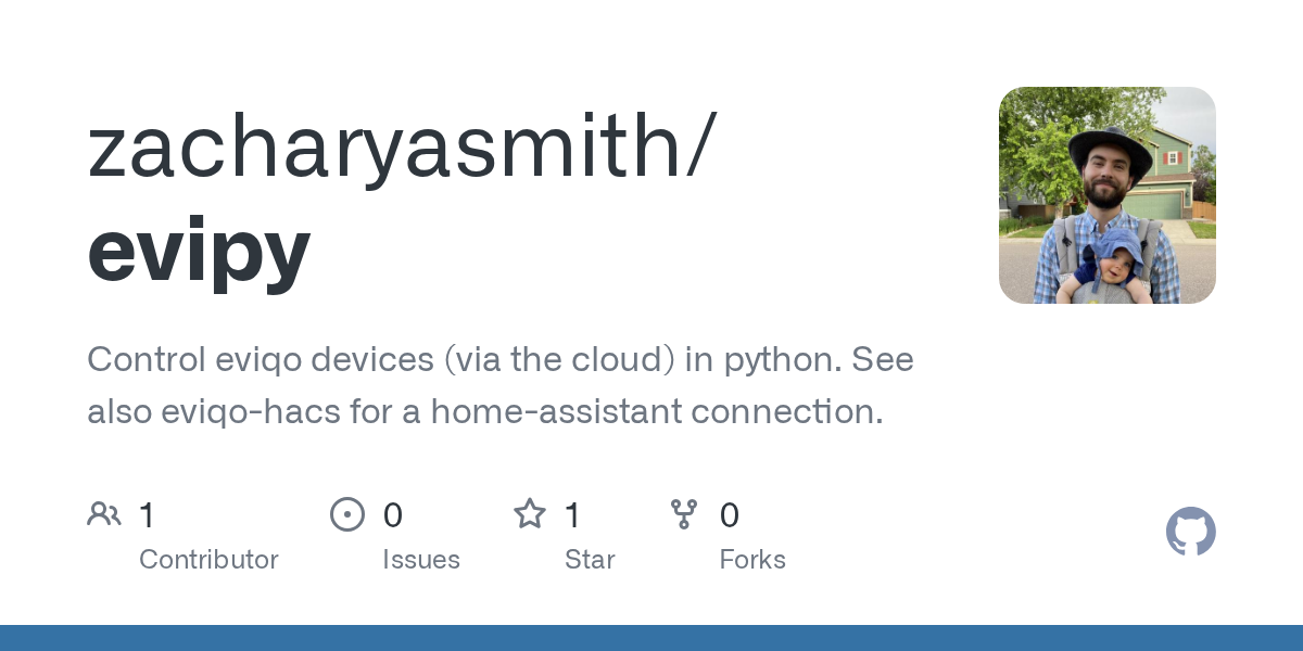

Hey there, I am well on my way to reverse-engineering the app.eviqo.io websockets protocol. I have not yet done a 3rd party HACS integration but am interested on this being my first one. Unfortunately the device is cloud only so its not the premiere “local polling.” If there is interest, I will publish it.
I pushed the repository that is successfully reverse engineering the websocket connection to the main website. Creating a hacs integration is next!

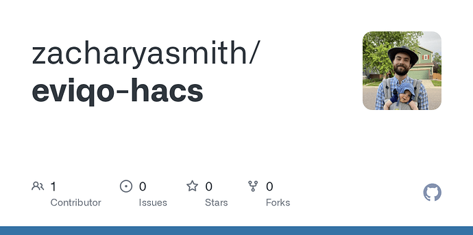

OK first draft is released and use at your own risk. There is some strange state logic that is required to be adhered to and it can cause you to need to reload the integration sometimes.

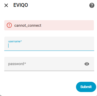

i tried and was able to import into the HACS storage. However when i try to connect to the same. i receive a message stating Cannot Connect.
I am also getting this error “cannot_connect”
Sorry all, I am not able to devote much time to this and I am guessing the company may be using a hostile API as we are having to connect to the cloud. Ideally we would be able to connect to the device over local LAN which I have not figured out.

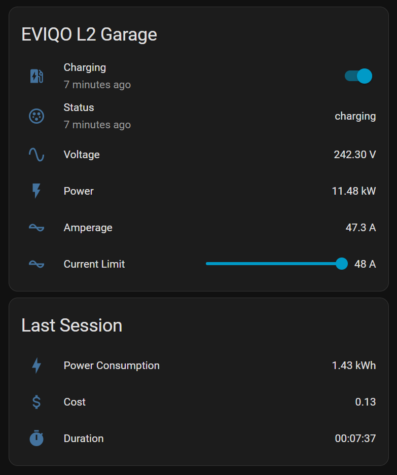

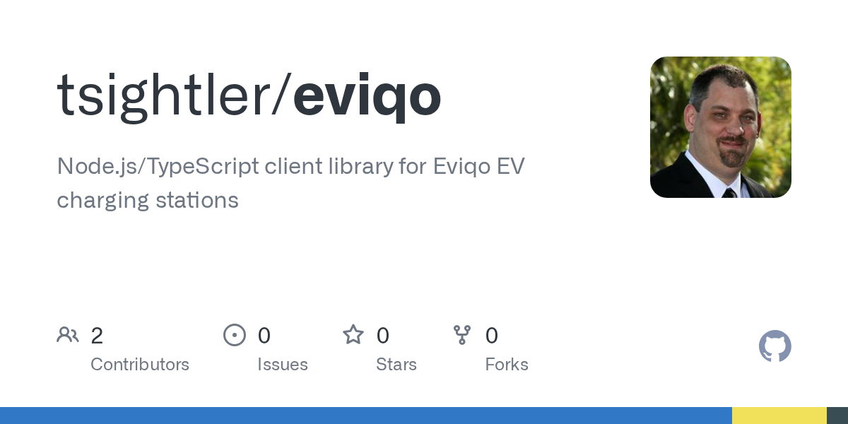

For those interested in this, I’ve created an MQTT gateway for EVIQO devices that also works as a Home Assistant addon (and generic Docker container as well).
The original basis was the API here, but I ported it to NodeJS (because that’s what I know from my work with ring-mqtt) and did a bunch of tweaks including adding support for setting the amps and for triggering charging startup. I’ve been using it for about a month and it seems to be approaching usable status. If anyone wants to give it a try you can add the repo to Home Assistant as an addon repo (not HACS) and install it, but you will also need MQTT setup and working.
Not trying to take anything away from the project here, but I really needed a way to use this device with MQTT because the EVIQO charger didn’t work well with my wife’s scheduled charging feature (thanks GM) and the app wasn’t quite flexible enough. I wouldn’t have managed to get this far without the work dr_ransom had done on the python API first!

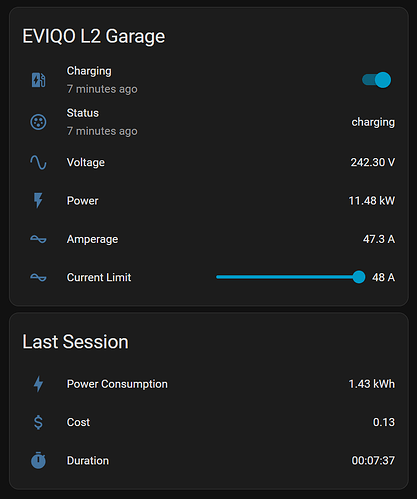

And a quick screenshot of a charging session in my HA Dashboard:
