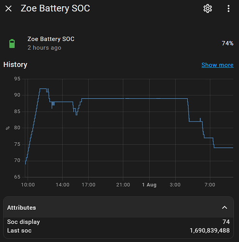

The way I went about mine was to do the following in my Renault Zoe EV.
I used an old android phone that was rooted and has a cheap data sim (contributes to my family data plan.
On that phone I installed Home Assistant Companion App, EV Notify and Tasker. Tasker works better on a rooted phone because it allows some extra system options like app kill and phone reboot.
I added a $5 hard wired 12v to USB port to the car so that the phone could be hidden away and kept charged.
I added a $10 Tuya USB micro switch and added to my Tuya account, in addition to EVNotify, this allows me with home assistant to monitor the car’s phone to keep the battery between 70 and 80 percent by cycling the USB power (to keep the battery from kept at full charge), and obtain the car’s location in Home assistant (so also works as a vehicle tracker).
This way EV notify is kept in physical range of the bluetooth OBD and has a connection to the internet.
I use tasker to reboot the phone every few days to keep it fresh, tasker also makes sure the phone hotspot is turned on at each boot so that the tuya micro switch has a wifi connection available so that it can also connect to the internet and my home assistant instance. I also kill and restart EVNotify with Tasker every 5 minutes because the Zoe CANBUS sleeps if not charging 6 minutes after the last door is closed. EVNotify seems to not want to reconnect sometimes after this happens, so I just refresh the app on a 5 minute cycle.
It’s a it long winded, but very reliable.

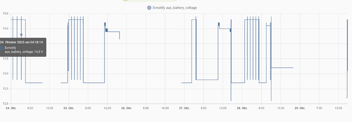

Do you also have problems with your Evnotify-sensors going to unavailble/unkown state?
Some weeks ago this problem started and sometimes even while driving/ charging the restful-sensors data go to unkown. Is there something like a “keep alive” signal? Or maybe I just the only one with this problem!
