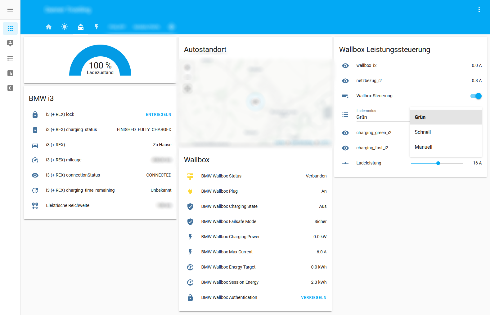

My current setup using some automations to set the charging power to use maximum PV power, maximum power at my grid connection point without burning the fuse (failsafe mode on) or manual. In addition, a charging operation is automatically authenticated, if my car is at home.
Any other ideas for cool features with our charging station?

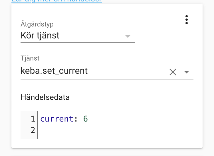

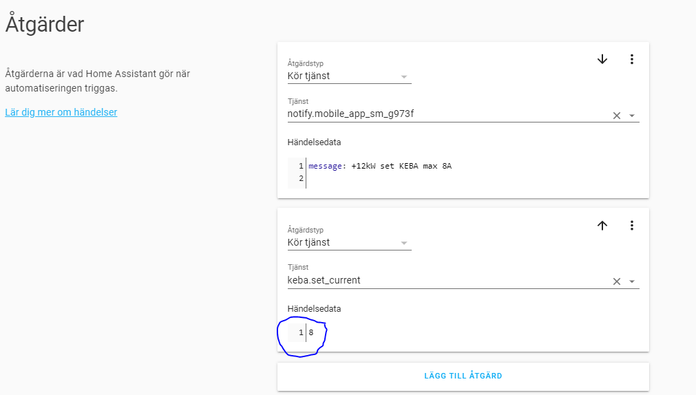

Hi all and thanks for a great integration!
I’m struggling a bit with Automation.
Here I’m trying to limit the current if i measure to high power drawn from the main supply to the house.
However the keba.set.current do not like if i enter 8, 8.0 “8.0” etc…what is the correct format?
cheers
Forgot to mentioned that i also tried
Current: 8.0
still no luck…
Any input is welcome
