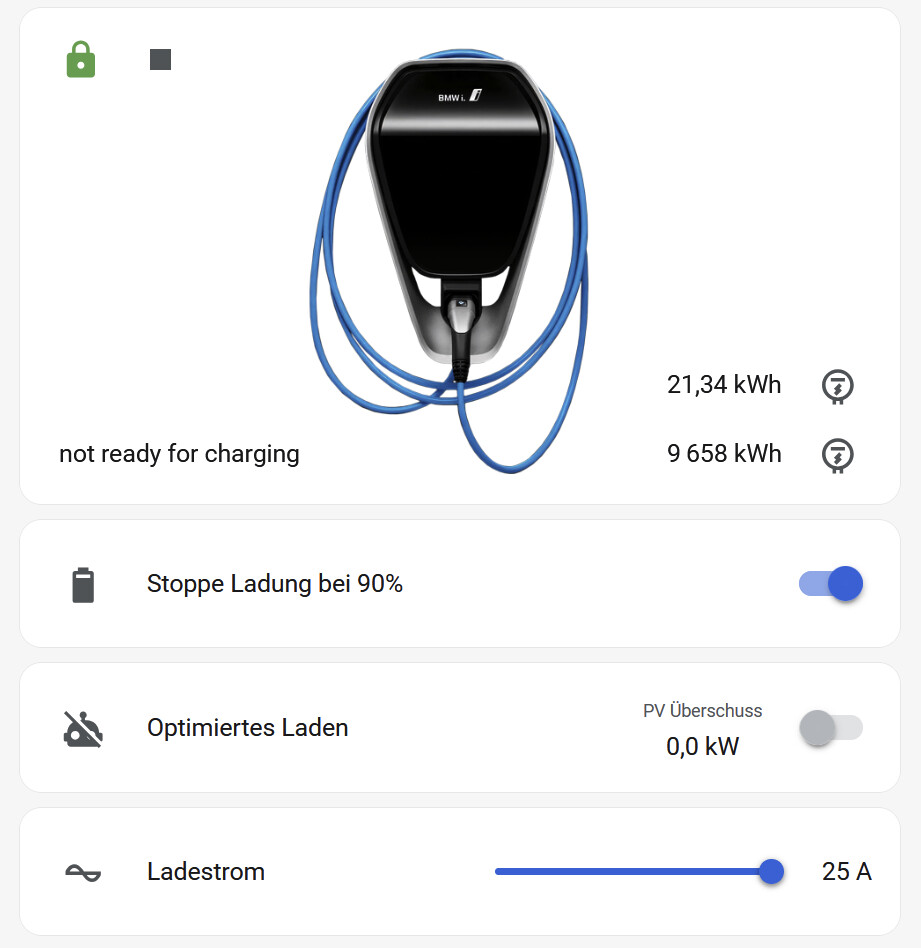

My current charging station card looks like the following (left with optimized charging off, right when optimized charging is on):
I have some automations and helper entities to calculate available surply PV production, control charging and stop charging when reaching SoC 90%. Depending on my “charging mode” and status of the charging station, different options are shown. During active charging, the UI changes as well, including the active charging power. Once the EV is plugged in, the cable is “rolled out” :wink:
You can check out the following configuration. It will not work out of the box as you probably do not have the exact same charging station and automation/helper entities in place. Still it might be helpful for inspiration.
Code for creating this card

I have also attached the background images here (first one is the blank.png image, thus not visible :smiley: ):
Hi @vic I like your dashboard but I cannot get it to work. I get these errors in the dashboard.
about the error messages you need to install the custom components slider-entity-row and button-card through HACS.
The warning messages are because the entities are not enabled on your integration.
You have to go to the setup and check the Keba integration. Some entities might be disabled by default. You have to manually enable them in case.
