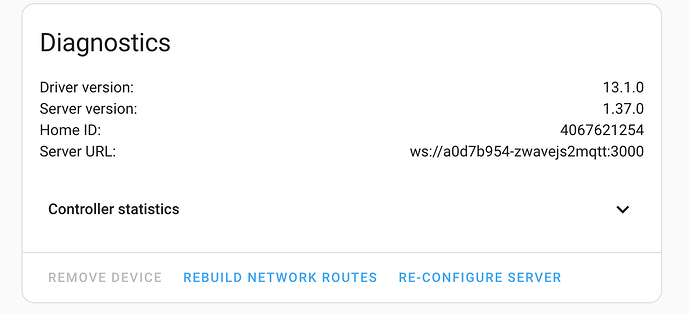

Actually, the device is still there and working fine. The greyed out “Remove Device” link is on the hub’s Configure page as shown in the pic.
Even though the exclude said it failed, you can always try it again. If you have problems including the node again, you will have to do the exclude again first then include. Alternatively if the device has a factory reset option that will remove the zwave network from the device but will not remove the device from the network (that is where the remove failed nodes comes in). Nodes will listen for an exclude command from anywhere which is why the device exclude procedure usually requires a sequence of presses not normally activated during typical use.
UPDATE: I did find a post talking about the greyed out link and the solution was to restart the add on. I went in and noticed I have two Z-wave add ons. Keep in mind I am kind of a noob. I’ll play with HA, get it working, and then return months later to do something forgetting half of what I previously learned.
Anyway, I have both “Z-wave JS” and “Z-wave JS UI”. At some point, I added both but am apparently using the latter one, because the other was stopped. I restarted Z-wave JS UI, got the greyed out link back, and tried to exclude the device again. Worked like a charm this time.
