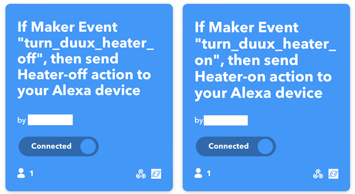

I have a DUUX Threesixty 2 which has the new chip and doesn’t support the old methods of adding it to Tuya. My workaround is similar to @acjtaal : use IFTTT Webhooks + Alexa to trigger commands and helpers + automation on the Home Assistant side.
How to:
  1. In the DUUX App (Gen 2), set up the Alexa integration
  2. In IFTTT, set up Alexa Actions by mkZense integrations. The free account allows you to set up 3 actions, you will need 2 of them. Make sure to not name them Heater since that can conflict with voice commands. I named them Virtual-Switch-On and -Off.
  3. In Alexa, set up 2 routines using those virtual buttons as triggers. Add an action → Smart Home → Thermostats → DUUX Threesixty 2.
For powering on, you can also set the desired temperature. What I noticed is that if you set the temperatue, it will turn on in Mode III (high = 1800W). If you don’t set the temperature it uses the lowest Mode I = 800W in my case. I haven’t found a way to power it on in Mode II (~1200W).
  1. In IFTTT: Create applets to turn the heater on and off. I use a webhook request with a specific event turn_duux_heater_on, which triggers the corresponding Alexa routine through mkzense (e.g. Virtual-Switch-On)
