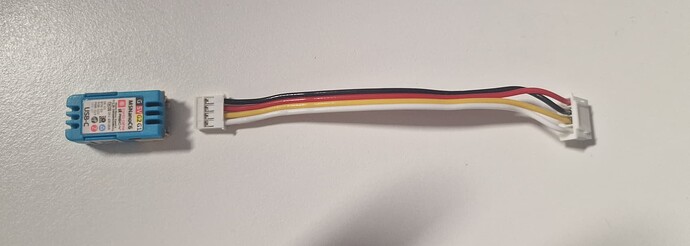

Specific for the connections part: did you took any photos of the actions you described?
I did not, but it’s very easy to unscrew so I made you some.
The four screws are under the white sticker on the bottom, you can feel where the holes are by pressing around a bit on the sticker.I used a small knife to cut out the holes. For me one of the screws was right under the serial number so if you are gonna mess around, might want to take a picture of that before it’s ripped.
You’re going to find the original Duux control board (that’s been posted around here a couple of times already) also in this product.
Pinch/press the tab on the original JST to disconnect the stock ESP board
For the M5NanoC6, this is the cable you need to prepare. (!! the black and red wires are crossed)
It’s an official M5Stack Grove Cable. Cut off one side, and crimp it to JST-XH 2.54.
If you have never done this; you can find various assortment kits and criming tools on Amazon / AliExpress etc. for a couple $€.
There’s also plenty of Youtube videos explaining the process.
Then just insert the Grove side into the M5NanoC6, and the JST into the mainboard of the ThreeSixty.
I used a bit of tape to make sure the wires can not be pulled into the fan.
If you ever want to revert the device to be fully original, just screw it open again, take out your M5Nano and put back the original JST and screw it back together. :grinning:
And yes, mine needs a bit of cleaning :see_no_evil:

Thanks all for the great work! I’ve successfully integrated my Duux Edge 2000 locally using ESPHome and an M5Stack Atom Lite (ESP32). I chose the Atom Lite because I already had it available, but an M5Stack Nano would also work perfectly fine. Below you’ll find my complete and working ESPHome configuration, including the correct GPIO pins for use with the Grove port.
I followed the examples provided earlier in this topic. It was as straightforward as uploading the provided code, modifying the cable, and everything worked immediately.
With this setup, everything works stable and locally within Home Assistant, completely cloud-free!
Hardware used:
  • M5Stack Atom Lite (ESP32)
  • UART via Grove port:
    • TX: GPIO26
    • RX: GPIO32
    • Baudrate: 9600
ESPHome Configuration:
