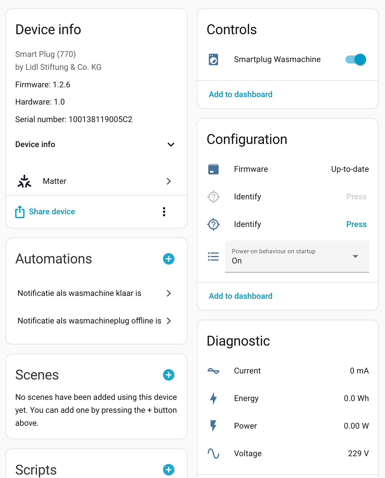

One thing that a lot of smart plugs can’t handle very well is running inductive loads, like motors (or devices that containing them), and especially switching them. I’ve been using one on my washing machine, but it’s always turned on as I only use it for keeping track of power usage so I get notified when the wash is done.
Works fine for me:
So does even “Energy” field populate for you? Other fields works fine for me also (incl. “Power”), but not “energy” - it always stays with zero value.
No, you’re completely correct: it doesn’t populate for me either.

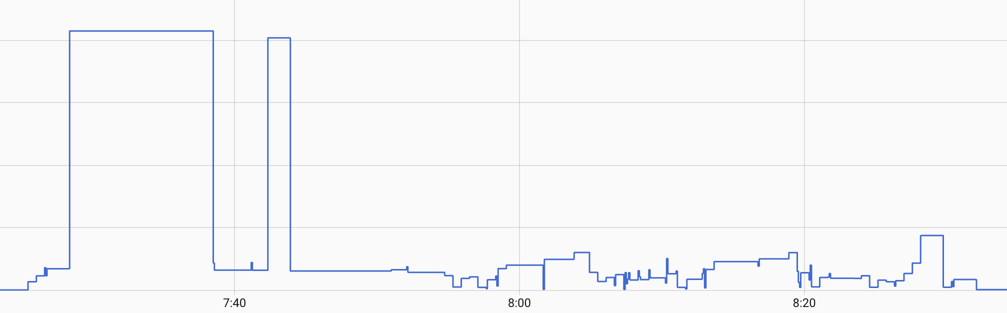

I don’t think that would be much precise for devices which often change its power consumption. Data from Smartplug are refreshing quite slowly.
It looks like it updates at least once per 5 seconds:
