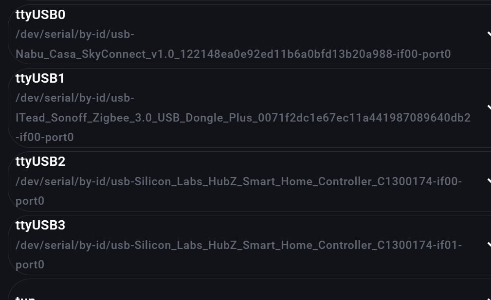

If the IEEE id is /dev/serial/… then no, they had 2 different id’s, I paid attention to those. If it’s something else, then I’m not sure.
