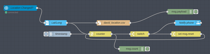

Found a method to do this. It turns out I was over complicating things a bit with SQL.
I ended up using Node-Red and templates to track the locations, and write them to a CSV file on my server. I also wrote a quick CSV2KML Python script that will transpose the CSV into a KML file that I need.
Node-Red flow
Basically, I’m using my phones geocoded location as a trigger. When it changes, I grab the timestamp, latitude, and longitude at that moment, and parse it to a CSV format, then feed it to a file node for writing.
I also added a sub-flow for counting how many records have been written, and notifying me every 100 records.
[{"id":"880a007a.354298","type":"tab","label":"Location Tracking","disabled":false,"info":""},{"id":"4948259d.a34434","type":"debug","z":"880a007a.354298","name":"","active":true,"tosidebar":true,"console":false,"tostatus":false,"complete":"payload","targetType":"msg","x":1010,"y":80,"wires":[]},{"id":"139874af.04494b","type":"api-render-template","z":"880a007a.354298","name":"Lat/Long","server":"8ffc691d.25e1f8","template":"{{ states('sensor.date_time') }}|{{ state_attr('device_tracker.my_coords','latitude') }}|{{ state_attr('device_tracker.my_coords','longitude') }}","resultsLocation":"payload","resultsLocationType":"msg","templateLocation":"template","templateLocationType":"msg","x":340,"y":140,"wires":[["cf70ebf5.99c72","7b1f1d0c.e91b84"]]},{"id":"1810ed7b.bcb34b","type":"server-state-changed","z":"880a007a.354298","name":"Location Changed?","server":"8ffc691d.25e1f8","version":1,"exposeToHomeAssistant":false,"haConfig":[{"property":"name","value":""},{"property":"icon","value":""}],"entityidfilter":"sensor.davids_iphone_geocoded_location","entityidfiltertype":"exact","outputinitially":true,"state_type":"str","haltifstate":"","halt_if_type":"str","halt_if_compare":"is","outputs":1,"output_only_on_state_change":true,"x":150,"y":60,"wires":[["139874af.04494b"]]},{"id":"cf70ebf5.99c72","type":"file","z":"880a007a.354298","name":"david_location.csv","filename":"/share/nodered/david_location.csv","appendNewline":true,"createDir":true,"overwriteFile":"false","encoding":"none","x":650,"y":140,"wires":[["4948259d.a34434"]]},{"id":"7b1f1d0c.e91b84","type":"counter","z":"880a007a.354298","name":"","init":"0","step":"1","lower":"","upper":"","mode":"increment","outputs":"1","x":580,"y":200,"wires":[["b68c21a6.f483a8","ad13b185.36b53"]]},{"id":"b68c21a6.f483a8","type":"switch","z":"880a007a.354298","name":"","property":"count","propertyType":"msg","rules":[{"t":"gte","v":"100","vt":"str"}],"checkall":"true","repair":false,"outputs":1,"x":790,"y":200,"wires":[["c3734777.9f772","70251345.3ebe84"]]},{"id":"c3734777.9f772","type":"api-call-service","z":"880a007a.354298","name":"Notify phone","server":"8ffc691d.25e1f8","version":1,"debugenabled":false,"service_domain":"notify","service":"mobile_app_david_phone","entityId":"","data":"{\"message\":\"Time to check logs\"}","dataType":"json","mergecontext":"","output_location":"","output_location_type":"none","mustacheAltTags":false,"x":1050,"y":140,"wires":[[]]},{"id":"af2a18de.f7e998","type":"inject","z":"880a007a.354298","name":"","topic":"","payload":"","payloadType":"date","repeat":"","crontab":"","once":false,"onceDelay":0.1,"x":360,"y":200,"wires":[["7b1f1d0c.e91b84"]]},{"id":"ad13b185.36b53","type":"debug","z":"880a007a.354298","name":"","active":true,"tosidebar":true,"console":false,"tostatus":false,"complete":"count","targetType":"msg","x":750,"y":280,"wires":[]},{"id":"70251345.3ebe84","type":"change","z":"880a007a.354298","name":"","rules":[{"t":"set","p":"reset","pt":"msg","to":"0","tot":"str"}],"action":"","property":"","from":"","to":"","reg":false,"x":1040,"y":200,"wires":[["7b1f1d0c.e91b84"]]},{"id":"8ffc691d.25e1f8","type":"server","z":"","name":"Home Assistant","addon":true}]
