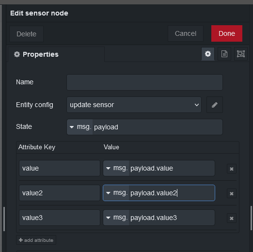

Current data is output to HA via the below:

If you add a unique_id to the yaml it will be managable from the UI
As for nodered, look for the mqtt in node and drag it out to the workspace. Open it and click the little pencil, add your mqtt server info. Enter the topic of the sensor. Connect that to the sensor node. When you first open the node, select the power config you posted above. Do not go to the config page.
On the same page there is an option to add attributes. Direct them to the corresponding message paths.
