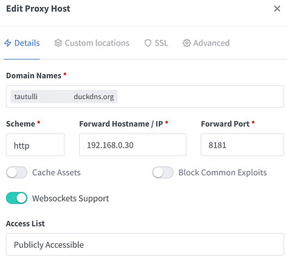

I’ve been working on this all day and at this point, I don’t know what it was that caused the issue. I’m unable to access Home Assistant via my duckdns domain, whether I try remotely or from the home network (that my HA rPi is on). I’ve got the Nginx Proxy Manager add-on installed with default settings:
From the Nginx web UI, I’ve got the proxy host configured with my duckdns domain and websockets enabled. Does the Scheme matter? I have it set to http as shown in the add-on documentation gif.
