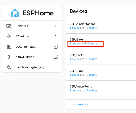

For some unknown reason I have 2 devices showing up, when I would expect only one:
When I click into the devices, I see this:
The 2nd mystery device (which I renamed Ghost) has no entities. How do I delete this device?:
