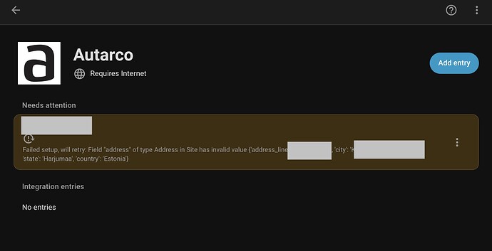

Hi. I have exactly the same problem. Automation says my current address is failed.
Which version of Home Assistant are you using? Otherwise please great an issue to get this checked/solved.
./Klaas

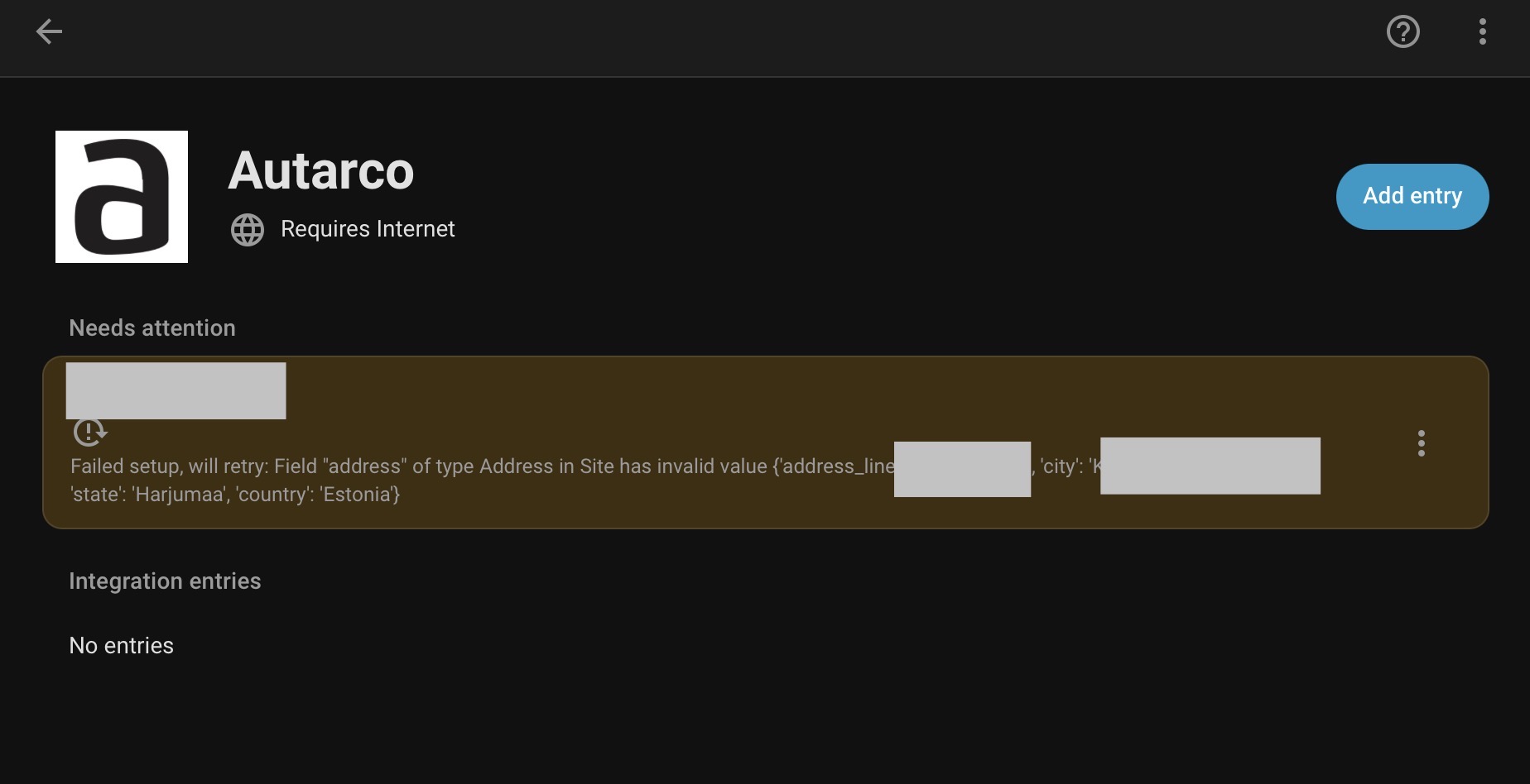

Hi, I just added your integration, but encountered another issue. It might have to do with that an inverter is offline?
Hello! Thank you for fast reply. I usually update software on time. My home assistance core is 2025.10.1. Hardaware is home assistance Green.
Both problems are actually issues with the Python package and are caused by how the response data is parsed. This is probably easy to fix, but I’d need to know exactly what the response data looks like for certain API endpoints.
What I have in log details file.
Logger: homeassistant.components.autarco
Source: helpers/update_coordinator.py:392
integration: Autarco (documentation, issues)
First occurred: 5 October 2025 at 16:57:21 (2917 occurrences)
Last logged: 10:09:38
Unexpected error fetching autarco data
File “”, line 24, in mashumaro_from_json
File “”, line 13, in mashumaro_from_dict_json
mashumaro.exceptions.MissingField: Field “zip_code” of type str is missing in Address instance
File “/usr/src/homeassistant/homeassistant/helpers/update_coordinator.py”, line 392, in _async_refresh
self.data = await self._async_update_data()
File “/usr/src/homeassistant/homeassistant/components/autarco/coordinator.py”, line 64, in _async_update_data
site = await self.client.get_site(self.account_site.public_key)
File “/usr/local/lib/python3.13/site-packages/autarco/autarco.py”, line 242, in get_site
return Site.from_json(response)
File “”, line 4, in mashumaro_from_json
File “”, line 26, in mashumaro_from_json
mashumaro.exceptions.InvalidFieldValue: Field “address” of type Address in Site has invalid value {‘address_line_1’: 'XXXXXX, ‘city’: ‘XXXXXX, XXXXXX’, ‘state’: ‘Harjumaa’, ‘country’: ‘Estonia’}
Thanks for the error log. I also see where the problem lies and that it’s already been fixed in the Python package. I just need to bump the package version in the integration, on my todo list for today :wink:
./Klaas
