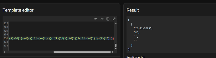

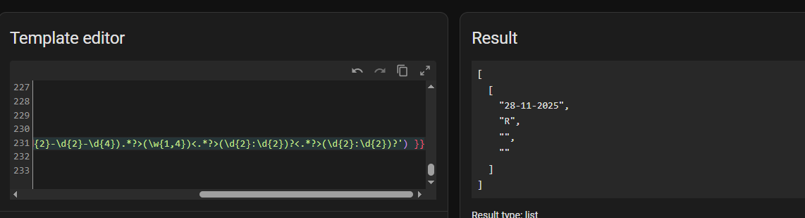

Can someone help me out with this. I receive every week a email with my shift for next week. This is send in HTML tables format.
I want extract following to add them into a HA Calendar:
Datum (date)
Dienst (will be the subject) (numbers are shift numbers, can also be GVL or R)
Begin: (start of the agenda item)
Einde: (end of the agenda item)
The rest is not needed.
Then I want add those 7 days into a HA calendar.

Not a pretty solution but splitting the table and regexing the contents does seem to work.
I assume the R means day off or something?
The regex currently skips them but that could obviously be changed.

{{ tbl.split('<tr>')[4] | replace('\n','') | regex_findall('(\d{2}-\d{2}-\d{4}).*?>(\w{1,4})<.*?>(\d{2}:\d{2})<.*?>(\d{2}:\d{2})') }}
So replacing the [4] with 5, 6 and so on gives you the days.
If you want to get the R-days then use:
{{ tbl.split('<tr>')[8] | replace('\n','') | regex_findall('(\d{2}-\d{2}-\d{4}).*?>(\w{1,4})<.*?>(\d{2}:\d{2})?<.*?>(\d{2}:\d{2})?') }}
In real life you need to split the html and then iterate it or something.
This is just a proof of concept.
