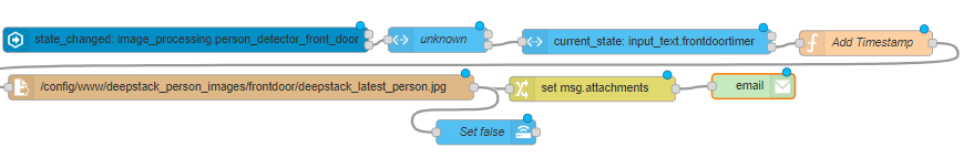

Thank you, do you have automations for when objects are detected?
I did it in node red
Hi
Can you share your node-red flow?
Thx
I have one of these for each of my cameras.
[{"id":"74434c3.ab3d1b4","type":"server-state-changed","z":"71c38478.f9382c","name":"","server":"5573076a.27abd8","version":1,"entityidfilter":"image_processing.person_detector_front_door","entityidfiltertype":"exact","outputinitially":false,"state_type":"str","haltifstate":"0","halt_if_type":"str","halt_if_compare":"is","outputs":2,"output_only_on_state_change":true,"x":225,"y":762.7500219345093,"wires":[[],["fdeb88ef.88ee78"]]},{"id":"fdeb88ef.88ee78","type":"api-current-state","z":"71c38478.f9382c","name":"unknown","server":"5573076a.27abd8","version":1,"outputs":2,"halt_if":"unknown","halt_if_type":"str","halt_if_compare":"is","override_topic":false,"entity_id":"image_processing.person_detector_front_door","state_type":"str","state_location":"payload","override_payload":"msg","entity_location":"data","override_data":"msg","blockInputOverrides":false,"x":528.5,"y":762.7500219345093,"wires":[[],["7f16dc93.fe7de4"]]},{"id":"7f16dc93.fe7de4","type":"api-current-state","z":"71c38478.f9382c","name":"","server":"5573076a.27abd8","version":1,"outputs":2,"halt_if":"true","halt_if_type":"str","halt_if_compare":"is","override_topic":false,"entity_id":"input_text.frontdoortimer","state_type":"str","state_location":"payload","override_payload":"msg","entity_location":"data","override_data":"msg","blockInputOverrides":false,"x":779.7500228881836,"y":765.000020980835,"wires":[[],["5e10fad7.98f824"]]},{"id":"5e10fad7.98f824","type":"function","z":"71c38478.f9382c","name":"Add Timestamp","func":"var topic;\nmsg.topic = \"Person Detected at Front Door at: \" + new Date().toLocaleString();\nreturn msg;","outputs":1,"noerr":0,"x":1043.5000343322754,"y":766.750020980835,"wires":[["bcc3933b.ce884"]]},{"id":"bcc3933b.ce884","type":"file in","z":"71c38478.f9382c","name":"","filename":"/config/www/deepstack_person_images/frontdoor/deepstack_latest_person.jpg","format":"","chunk":false,"sendError":false,"x":291.5477294921875,"y":820.0833559036255,"wires":[["344fb993.491ac6","41b2e147.8240f"]]},{"id":"41b2e147.8240f","type":"api-call-service","z":"71c38478.f9382c","name":"Set false","server":"5573076a.27abd8","version":1,"debugenabled":false,"service_domain":"input_text","service":"set_value","entityId":" input_text.frontdoortimer","data":"{ \"value\": \"true\"}","dataType":"json","mergecontext":"","output_location":"","output_location_type":"none","mustacheAltTags":false,"x":586.2500534057617,"y":874.2500228881836,"wires":[[]]},{"id":"344fb993.491ac6","type":"change","z":"71c38478.f9382c","name":"","rules":[{"t":"set","p":"attachments","pt":"msg","to":"payload","tot":"msg"}],"action":"","property":"","from":"","to":"","reg":false,"x":714.3570175170898,"y":822.0358333587646,"wires":[["49b61079.4d2ea"]]},{"id":"49b61079.4d2ea","type":"e-mail","z":"71c38478.f9382c","server":"smtp.gmail.com","port":"465","secure":true,"tls":true,"name":"","dname":"","x":908.0001106262207,"y":818.7501864433289,"wires":[]},{"id":"5573076a.27abd8","type":"server","z":"","name":"Home Assistant"}]```
