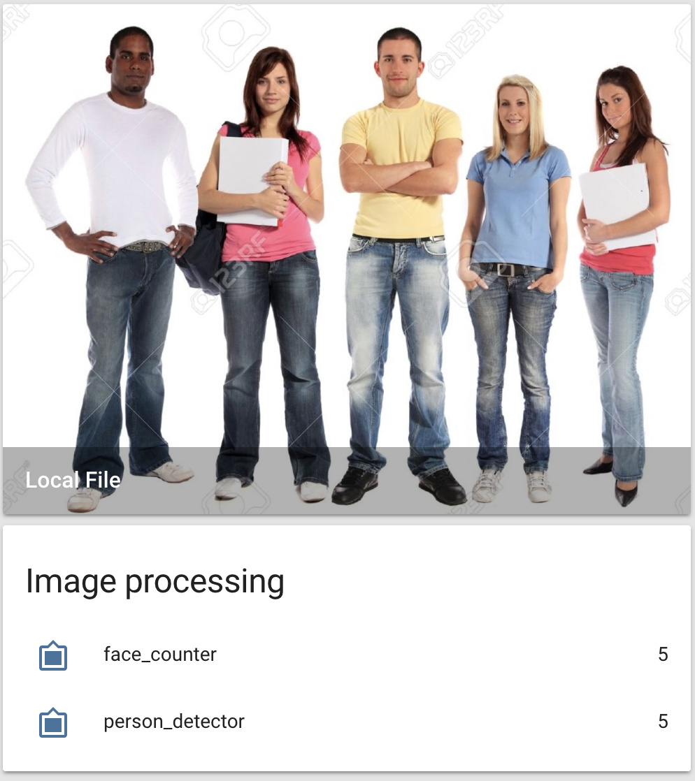

I just published a custom component for face and object (e.g. person) detection using Deepstack, which runs locally in Docker and costs you nothing. You will need a computer with a decent amount of RAM available, as Deepstack is using deep-learning models. Therefore don’t expect to run this on a pi, but a spare laptop should do. Any feedback on usage here, and bug reports on Github.
