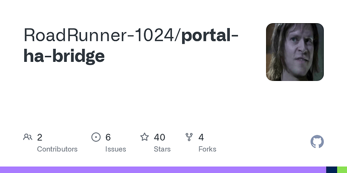

How does Ava Pro compare to Portal HA Bridge?
The main difference is AVA Pro is not a launcher, running lots of independent applications tied together. AVA Pro is a single unified piece of software. The assistant built into AVA Pro is a fully flegged ESPHome device, the same as the Nabu Casa Box. Portal HA Bridge uses a third-party assistant which requires third-party keys.
AVA Pro has a sendspin media client built-in (with a very nice display), so it can play directly from Music Assistant or Home Assistant as a remote speaker. Portal HA Bridge is dedicated to the Portal. However, AVA Pro has a portal add-in, which adds the additional sensors, presence, light, tilt, etc.
If you want a dedicated home assistant voice satellite, AVA Pro is a much better choice. If you just want to bring back some functionality to the Portal and use it as a tablet, look at Immortal
