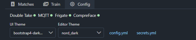

Same problem as @customstudioyandexru
If you hover your mouse above the red symbol, it shows the last error message.
