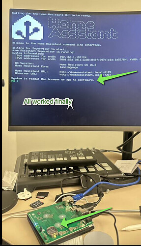

I’ve been dealing with DNS issues on my Home Assistant Green and after trying everything without success to fix the issue, I decided to factory-reset it using the official guide (Resetting Home Assistant Green using an SD card). Unfortunately, following those steps seems to have broken my HA Green it no longer boots properly. I tried flashing three different microSD cards, but none of them successfully reinstall Home Assistant OS. The device always hangs during boot and eventually drops into the emergency CLI.

there’s messages in one of those pics about the real time clock (rtc) vs ‘low voltage’
Solution
  • Open the green, installed a coin battery ( CR2032)
  • re flashed and the Green worked
So if you are having issues with flashing the green consider installing the CR2032 battery and try again
the steps are missing this critical points when you get the time sync error * Time sync fails, and this triggers the “low voltage detected, date/time is not reliable”, (Install a Battery and proceed with flashing)
