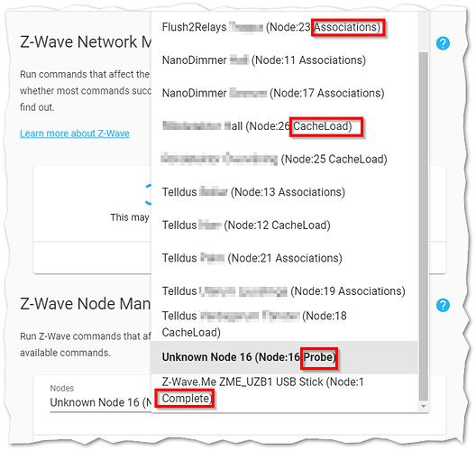

Ok, I have not tried to use a tool to remove it from the USB Z-wave stick yet… I have a Z-Wave.Me UZB stick, don’t find any tool from that manufacture.
But, today, after letting the HA try to start the network since 13:00 yesterday until this morning it was actually started, it seems to work in one way, but not responsive at all, tens of minutes…
I tried to trigger a remove failed node, but get this:

If I try “Heal network” i got this:

What to try next?
