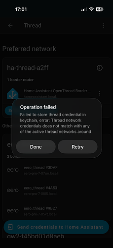

I have the same issue trying to save to iPhone. I can’t save them via my iPad either. This is what mine looks like. All my devices are on iOS26.2. I assume my ZBT-2 is the preferred network. Am I meant to Send credentials to Home Assistant first. I do have some devices on HomeKit network. Ideally I would move them over to Home assistant.
I think what the error means is that iOS (and Android as well) stores Thread credentials that are associated with a particular TBR, and the TBR sends out mDNS advertisements and the iOS device is expecting to see the advertisements from this particular TBR and doesn’t see them. This is a bit of a guess, however.
On the other hand, if you have a Homekit network already, chances are you already have Thread credentials stored on your iOS device. In your iOS HA Companion App, go to UI->Settings->Companion App->Debugging->Thread and see what Thread credentials are already there. You may want to instead send your credentials to HA and then go to the Thread Integration and see what networks show up with the (i) icon which means HA has Thread credentials from that Thread network. If one of those with the (i) is not the ha-thread-xxx then may want to make it preferred, and HA will in turn move the ha-thread-xxx to that network.
I had a look in the log as you suggested. It only had credentials for the HomeKit. I have transferred those credentials to the phone and now I can make HomeKit the preferred network. I don’t want to do this. I want the ZBT-2 to be the preferred network. The HomeKit and ha-thread network have (i), the Eero and IKEA do not. I still get the same error when I am trying to send credentials to the phone. Should this button disappear if the credentials are sent successfully, or is it always there?
Once you made the HomeKit the preferred network, then HA should have also made its own OTBR part of the preferred network. When this happens, it means that HA and Homekit are part of the same Thread network. The only difference would be that the Thread credentials stored on your iOS device are likely associated with the Apple device acting as the Homekit hub and not associated with the HA OTBR.
One thing to try is goto UI->Settings->Companion App->Debugging->Thread, click on the Thread credentials, and slide to the left and delete it.
In the Thread integration, go to the ha-thread-xxx entry and click on the 3-dots and set it to be used as the Thread credentials for iOS/Android, then try sending the credentials to your iOS device.
