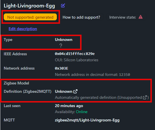

One IKEA bulb does start the interview but returns “Not supported”, “Model: Unknown” and “Type: Unknown”:
