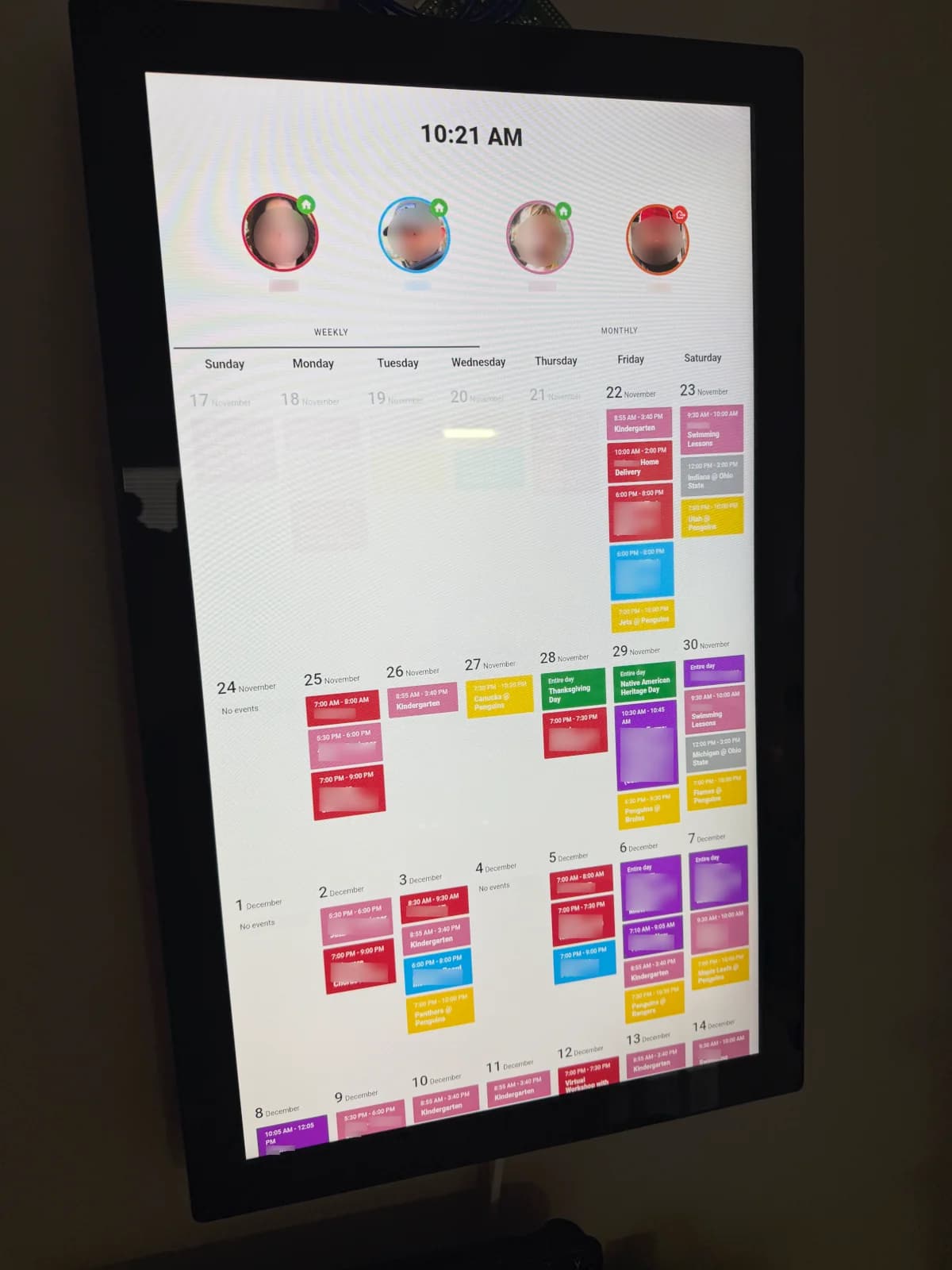

There is a family calendar in this reddit thread, posted by SeanHarsh.
And it reads as if it was created in HA Dashboard.
Does anybody know or could explain how you get it to look this slick please?
https://www.reddit.com/r/homeassistant/comments/1gx610u/family_calendarplanner/
He is using the week-planner-card to do it, but Ive tried several attempts and cannot make it look this nice.
I’d love pictures of the family at the top, in coloured circles that match a key/legend at the bottom.
Then color coded to the events as well.
Still too new to figure it out.
Guidance is very much appreciated

Is that the one you’re talking about?
