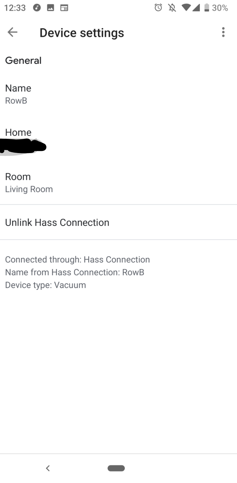

  • The in-app icon displays a gear in the corner and has no on-screen controls. Selecting it takes me to the settings page in the Google Home app.
For the vacuum:
  • Controls do not work in-app OR by voice. (Google Assistant tells me there was an error when I try to turn on/off the vacuum)
  • Similar to the fan, the icon has a gear in the corner and tapping it takes me to the settings page.
Screenshots below showing the gear icons and settings page showing they’re successfully imported from HA:
